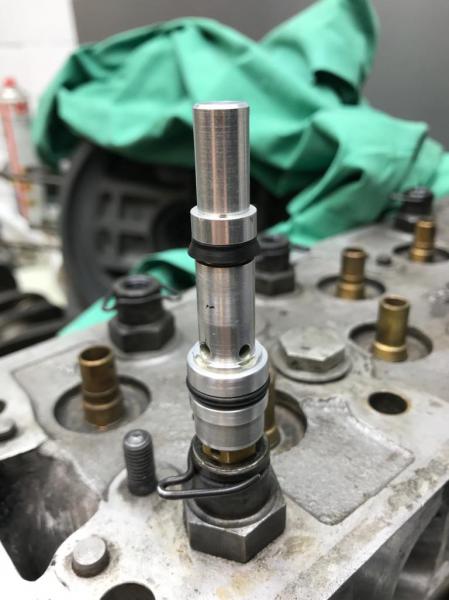

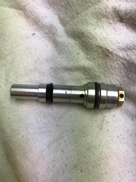

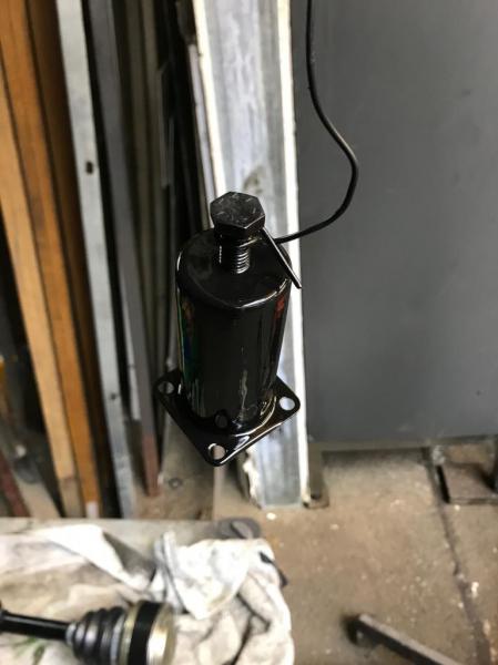

Wolfgang,
I now can rebuild the e9 Brake Pressure Regulator, I just finished my first one.
I searched high and low for 6 months, for the Rubber Seals.
I finally had to have them custom made, and this time they fit, but theywere are hard to install,
As most rubber is not sutibule for Brake Fluid.
And I had to order a more supple rubber that allows it to be streached onto the piston!
But as you are in Europe, and I am in the USA in CA.
